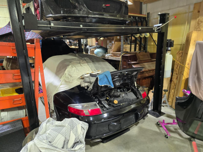

A few years ago I sort of accidentally a 2002 911 C4 Cabriolet. A woman at my office had it, and after making horrible noises, took it in and determined it had an IMS bearing failure which scraps the engine in these.....and is unfortunately rather common.
With only 56k miles, manual, black on black on black and cheap I was interested. Since it wasn't an S, or a turbo, or a coupe and of the least desirable generation of the 911 I got it for 5K. It is really really nice shape (minus the engine). A rebuilt/sorted engine for these can run 14-20k.....ha....no. In perfect shape with a good engine, these would AT BEST get $30k....probably $25k.

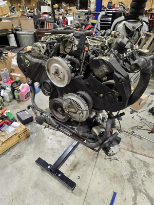

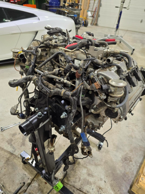

So, I know nothing about Audi's and nothing about porsches, but here I go. Engine teardown begins. What you see in these pics is AFTER I removed the exhaust manifolds and turbos and A LOT of tubes and pipe...still so much to go. 90% of this won't be re-used. The engine itself is very stout, the issues arose from improper maintenance because they were nightmares to work on when packaged in the audi. Not only am I removing the problematic stuff, It is actually easier to work on in the porsche.

Wow what a project, I always wondered how you got an engine out from these, by the rear by removing the bumper or from the bottom? I can't believe you got an engine and shipping so cheap, I doubt we could get anything under under 2K over here.
