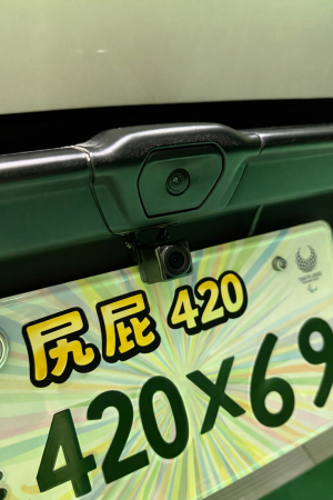

Happy to share a great experience for anyone in the Chicago area looking to add a digital mirror with front and rear cameras to their Sterrato (or non-Sterrato Huracan). I found Showtime Audio in Chicago that had posted a similar install to a Huracan Sterrato. They installed a Rydeen X10-SPL system a few days ago and did an awesome job. Jerry Villa, the owner, and his team were great to work with. They also designed and did a 3D print of a nice cover for the rear camera since I wanted the camera mounted on the air scoop to give me views of my blind spots. You cannot tell the mirror is not stock, the mount is a perfect replacement for the standard one. Reach out to Jerry Villa at Showtime Audio (https://showtimeaudiochicago.com) as they are open to selling the camera enclosure if anyone needs one for a local install.
