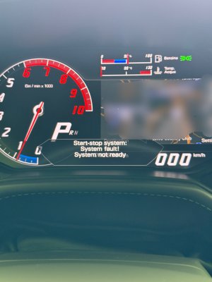

First engine restart: EMS (Engine Management System) warning came on, no CEL, start-stop failure, parking sensor was OK, and selecting Corsa turned off the EMS.
Second engine restart: EMS stayed on, CEL came on, start-stop failure, parking sensor was OK, and none of the driving modes turned off the EMS.
Third engine restart was the same.
What do you think the problem was, without using an OBD2 reader?
I did something, then EMS went away, and after 3-4 engine restart, the CEL went away and everything went back to normal. No exorcism involved.

BINGO! It was a bad pedalbox. Took it off and problem was fixed. Took like a day for the CEL to go away though.
Start-stop failed too when EMS or EPC kicked in.

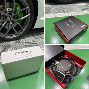

The new unit arrived from Germany in just three days. Pretty impressive. I had emailed them asking for a quick shipment since the old one broke, and it feels like they went the extra mile to get it programmed and sent out lightning fast.
I have unpacked and installed it. I chose the wired version since I do not really trust Bluetooth.
