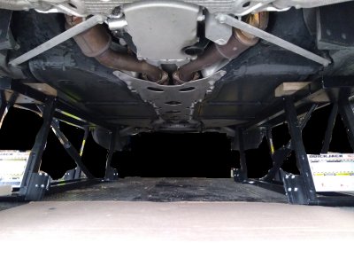

@REKIII reading your post on the other forum I see you have a set of quick jacks, never used a set myself but curious how sturdy they are when you introduce lateral movement/pressure on them.
I found it funny even the cop didnt know how to use a scissor jack. Guys lucky to be alive.
They are 12" wide, you are not going to push a car sideways. The Vette has been in the raised position for 4 months.

I own / use Quickjacks on occasion as well. Of course, it doesnt fit my new-to-me M3, which is kinda crazy. The jack points are so darn far apart on that Bimmer. If I could sell this QJ set, I'd probably use the cash to get a 4post lift...they arent as expensive as I once thought they were. The QJ is pretty darn rock solid when its up.
They might sell extensions for it.
50
i know some folks on the BMW forums made extensions out of steel tubing or something, but I wouldnt mess with that for various reasons....and some folks use them with the jacks perpendicular to the frame (sideways). I won't do that either, though, i dont think
If I needed mine to be lengthened I'd weld some extensions. I fabricated brackets and put wheels on mine otherwise it's nearly impossible to move.
Seems like the other gents answered well, but yes, the QJ's are very stable. no racking. I'm very confident when under or around them. I open the door and get in and out of the car and there is zero movement. Hardest part is getting them into the correct spot without blocking anything you need to get to.

In earthquake territory in addition to quickjacks I would put 8"x8" lumber running across the car front and back. The jacks could fail but it would be safe.
