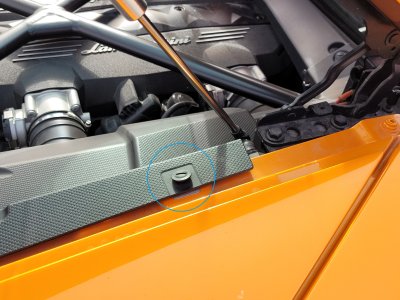

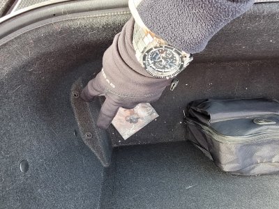

The car was severely neglected, Missing all bolts holding the tub in the frunk, 1 engine trim panel not even screwed. The tub was full of pet hairs, dirty carpets, dirty engine trim.

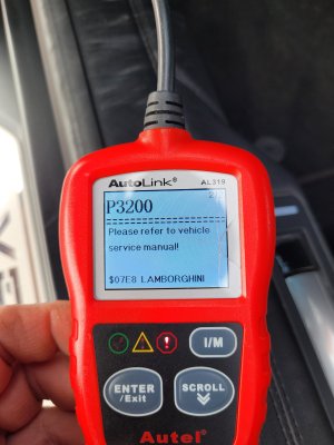

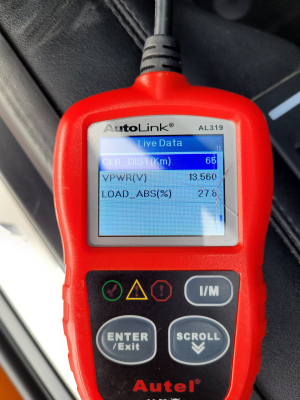

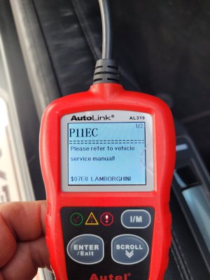

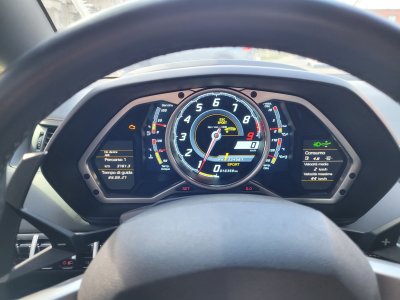

The check engine light was on when I turned it on. With a scan tool I found they had cleared the engine codes 65 km prior to my visit (8 of those was my test drive),

When inquired about the check engine codes the seller stated it might be due to straight pipes. That also didn't make sense because the car wasn't loud and he didn't disclose this earlier.

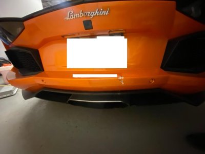

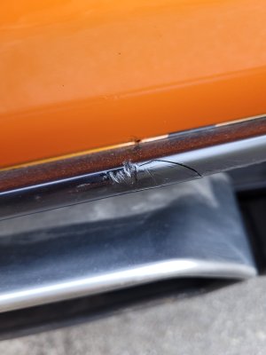

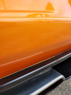

This is what you get for a 124K repair claim for a hole in the bumper, a crack on the trim below and the 3rd brake light cracked and a few other things.
This is the repair, crack still there and body filler where you see drill marks :
This is allegedly a new bumper

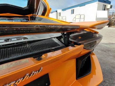

3rd brake light is cracked, this is what you get...some clear tape
All tub bolts in the bag, why you need to access the battery frequently?
Codes cleared 65 km (-8 km test drive) prior to my visit

I am sure the CEL will stay on forever, no matter what you do, even after piles of repairs and putting everything back to stock. The proper fix probably needs a certified dealer to do it right and that means serious money. Think three or four times the repair estimate. The CEL will still sit there and laugh at you. The car will not drive normally, no matter what the seller claims about it having no effect.

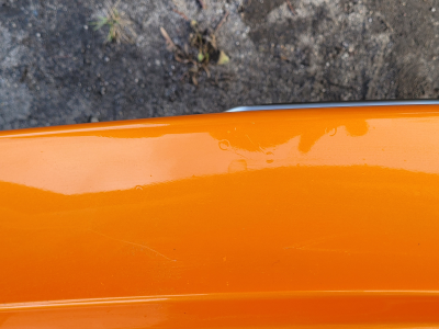

"The Devil is in the details" quite literally.

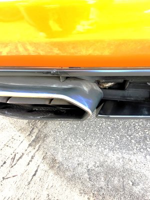

You can see overspray, another proof they didn't replace it, they didn't take the bumper off to fix it and paint.

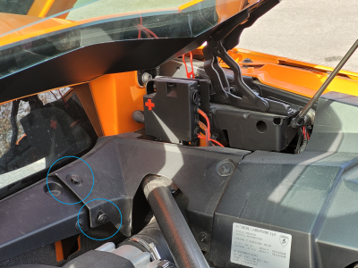

So the car took hits from the front and the back and its insides look like they want to escape. They drove the car into a trash compactor. It would take a huge impact to bend carbon fiber like that, to the point even the bolts cannot keep it in place. I'm pretty sure the frame is bent somewhat and PPI won't pass.
Only the rear took a hit. The loose trim bolts, someone wasn't patient enough to screw them in properly.

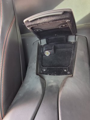

Even pet hair in the armrest console, no pride in keeping this car clean.
