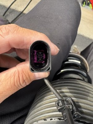

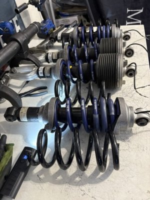

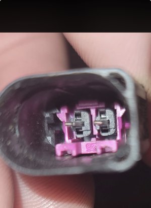

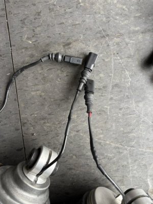

The couple of videos I saw on this seemed to underestimate the de-pinning portion of removing the OEM springs. Man, that was kinda painful. See before/after pics. The pins/purple holder, etc took a beating so bad on the first one that I experimented on that I decided to scrap all 4 of them and replace with some Amazon versions (should've done that in the first place). Second, I had to remove the small intake snorkel (for lack of a better word) for the rear two shocks in order to get a tool on those top shock bolts (that wasnt mentioned in the couple videos I found on youtube). Those are the tips that I can offer at this point.

as for the pics, first is OEM undisturbed, second is after I butchered de-pinning/re-pinning and 3rd are the new connectors spliced on

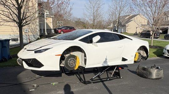

lol - apprec the feedback. Its even more crazy that I am lowering a car that I have to fall into already...and will likely cause issues with lifting on the quickjacks (prob need to put on small blocks before lifting), etc...but I got a little bored and I kinda enjoy messing with stuff, so here I am. I generally do exhaust/wheels/lower/tint everything I have.

in order to pull the orig springs off, u have to pull the wiring for adaptive suspension thru a small hole in the “tophat/eyelet”. Wire barely fits even depinned…i think u can see what i’m talkin about in the last pic

The key is finding the exact pick and extreme patience. When you are about to kick the car I cut the damn thing off and I solder regular connectors and heat shrink.

My kit incl about 80 of those flimsy keys that all seemed about the same. I definitely should've just cut them off right from the start
