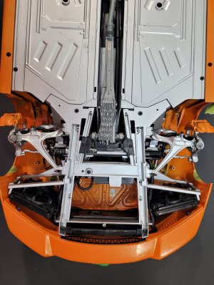

The front end portion is complete, frame, front differential, battery, suspension, painted calipers, rads and hoses and even the front lift with painted air lines(red and green).
I know there are red stains on the frame I need to wipe off, the red paint doesn't want to dry!
Even the battery has accurate warning decals and ground wire attached to the frame (see left screw on the frame)
The rack and pinion which turns the front wheels was atrociously cast, the splines didn't line up properly and the rack was locked in place. It took me a few hours to file each groove of the rack and file the pinion gear with miniature files to get a smooth operation. (Red paint brush pointing to rack and pinion)

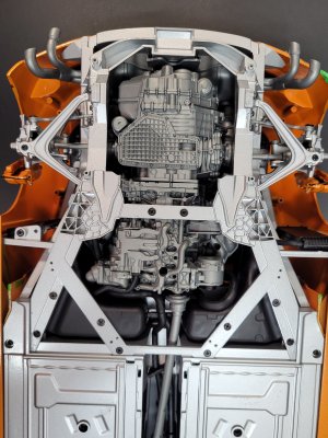

I'm wondering if should I assemble the engine trim like in the instructions,(mesh grill not shown) or somehow try to do custom trim pieces like I have on my actual 610-4 car? I didn't think it over but it would be a big undertaking to make custom panels and cut out the cast metal.

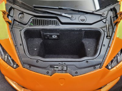

This evening I finished the frunk storage space with the 12 Volt plug and lamp. I mixed some green and yellow to get a close match to the emergency pull handle, I also painted the emergency back plate black as the sprue was gray. As detailed as the model is they didn't make the tool bags, bummer.

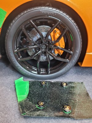

The wheels were not the same color and it was easily changed, I'm happy it's the same pattern (Mimas).

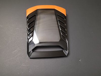

My heart sank when I was looking forward to painting the wheels and I had done a perfect black paint job. I waited too long to put clear coat and when I did the paint started to wrinkle a few moment later! I debated trying to find a complete diecast kit or sand the wheels down. I decided hours of my time was more reasonable however it took over a month of toiling tediously with eyeglasses and jeweler's visor sanding all crevices. It took me over 13 hours to sand out the wrinkles!

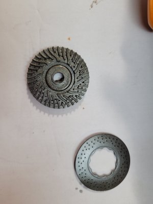

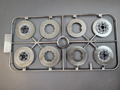

These rotors were silver from the spruce as seen on the tab. A variety of 6 paint colors to come close as I could to the real thing.

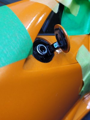

Detailing the gas cap was also a pain in the butt, well everything is. I had to reshape the hinge it didn't want to open at first.

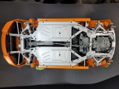

A few more pictures. I started to paint the undercarriage screws where they will be seen like the rockers and somes screws in the frame.
