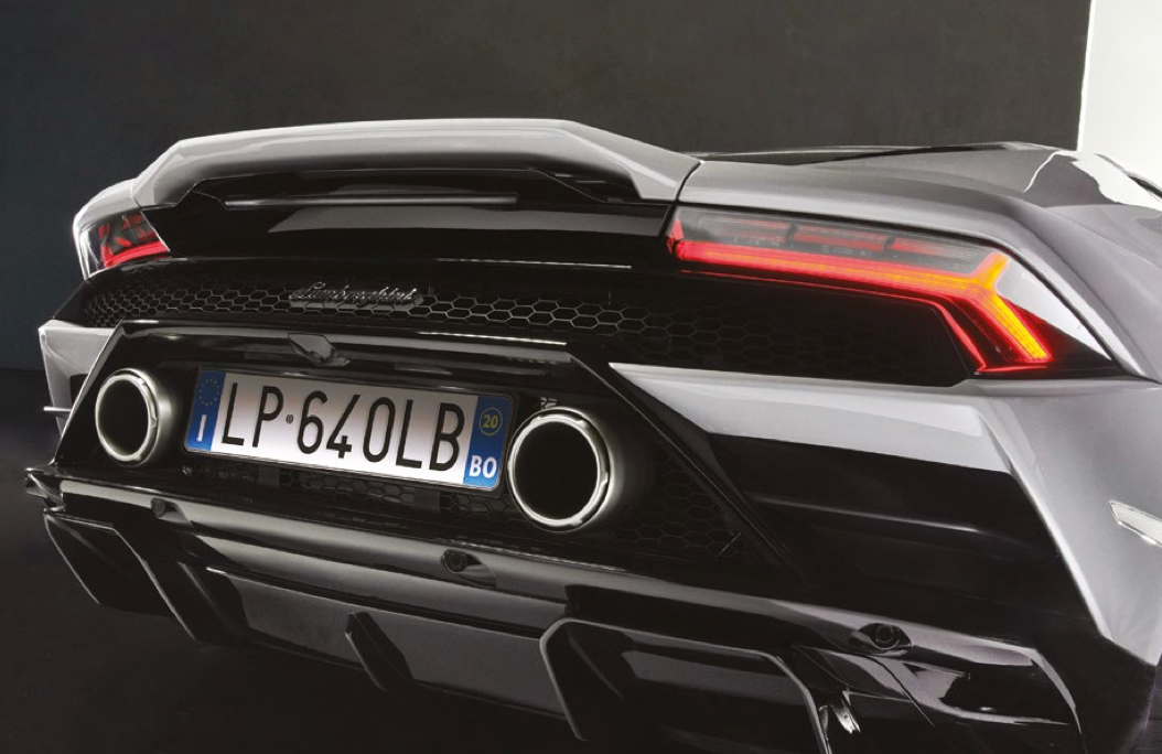

Yes, it seems to be quite a rare option especially on 2015 models as I don't think it was available right away for early cars. I remember reading the OEM race exhaust for the Huacan was a $12-15K USD option when it first came out. The factory sport exhausts are even more than that for newer Huracans.
Lambo does offer a factory titanium sport exhaust (via Akrapovic) for the Perf and Evo. You can see the prices on the Grand Touring boutique website in Canada. It's about $17K CAD for the Evo and somehow the same exhaust is $20K for the Perf...I doubt it makes much difference especially for that price. The mid-mount stock exhaust is already essentially a straight pipe.
Lamborghini - Huracan Akrapovič Titanium Exhaust – Grand Touring Automobiles

I think the fastest way to determine race / sport / stock exhaust is to open the bumper and look at the exhaust itself? The pipe diameter for race exhaust is much smaller like smaller tubing.
1,301
Interesting, I don't know if the sizes of the ends differ or what size each has. Even if you took the bumper off you have to remove the heat shields to go check out the plaque.
